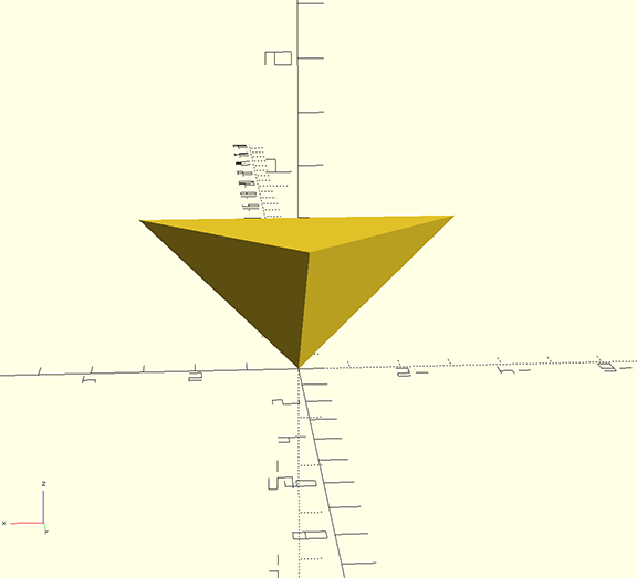

| Description | importing a CSG file with rotate_extrude, or using rotate_extrude in the add openscad element in the openscad workbench always uses default values ignoring set ones (true at least for angle and $fn) It looks like freecad doesn't have an option matching $fn in the menus, but it does have support for angle, but that is ignored as well | ||||
| Steps To Reproduce | In the openscad workbench press add openscad element and add the following. It should add a pyramid (works correctly if as mesh is ticked), but adds a cone instead Importing the matching CSG file results with the same effect, presumably, that is the intermediate format for communicating with openscad  | ||||

|  | $fn is optional, to quote the OpenSCAD documentation "$fn is optional and specifies the resolution of the linear_extrude (higher number brings more "smoothness", but more computation time is needed)." It is all about creating a smooth a mesh. Now if the user has the workbench option 'maximum number of faces for polygons set to a sensible value, then any OpenSCAD circle, polygon with greater than setting should be imported as a circle so $fn should not matter. |
|  | OpenSCAD users often use $fn to deliberately create non-smooth objects: in this particular bug report it seems that @laughingrice does indeed want a pyramid, and not half a cone. I am handling it the way we do in the cylinder code: if $fn is larger than the MAXFN value in the user's preferences we treat it as infinite, but if it's lower we treat it as though the user is deliberately creating a faceted surface. |
|  | Sorry don't follow, in that what is being extruded is on the stack, so should already be subject to the $fn for the operation that created it. Not sure that applying $fn to something that is already on the stack is a good idea. What is on the stack could have been created by a number of OpenSCAD operatives. |
|  | I've attached an image of what OpenSCAD generates for this operation. |
|  | So the issue is with a low value of $fn not a high value. |
|  | Right - I am following the example of the logic found in the cylinder code: So if the input fn is high, it's doing the normal surface of revolution. But if it's low, it creates a more prismatic shape. |

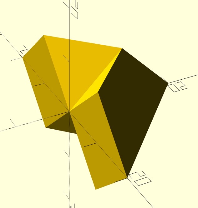

|  | I see Produces attached imageSo the $fn is determining the base of object and what is on the stack the sides. Was not aware that was what it was doing. |
|  | Will teach me to read the manual rather than make assumptions, thought it was like extrude with an angle, rather than rotate about the z axis. Tried And get the result as per picture. The problem I see is that when the rotate_extrude gets to be executed, what is to be rotated round the z axis is on the stack. (Being on the stack is a result of CSG being a script type language that has to be parsed.) Now with a low $fn, the $fn needs to be applied to things on the stack i.e. retrospectively and what is on the stack could in general be quite complicated, there is no rule that says it has to be one simple shape. |
|  | Forget what I am saying, the problem is not what on the stack it, it if a low $fn value is specified one has to use something other than a Part::Revolution to get the end result. Part::Revolution works when one want to make a smooth rotation. Have to code polygon once as per shape on stack and then at $fn * angle / 360 degrees with a cross section as per shape on the stack. |
