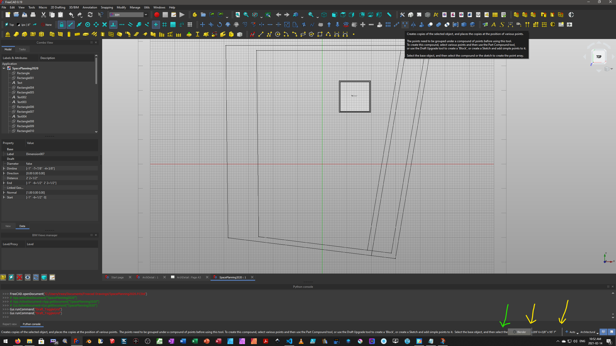

| Description | The Green arrow in attatched image points to text running under the button and pushing the QSpacerItem Widget? into the other QSpacerItem Widget? Text should be truncated or word wrapped? | ||||
| Steps To Reproduce | Hover over Make Compound Copys button as seen in attached image | ||||
| Tags | stylesheet | ||||
| FreeCAD Information | OS: Windows 10 (10.0) Word size of OS: 64-bit Word size of FreeCAD: 64-bit Version: 0.19.23756 (Git) Build type: Release Branch: master Hash: 9c6e9184930a52b165a0b7274e3a45d1006bfe67 Python version: 3.8.6 Qt version: 5.12.5 Coin version: 4.0.0 OCC version: 7.4.0 Locale: English/Canada (en_CA) | ||||
| related to | 0004566 | closed | Status Bar Verticle Spacers are not visually pleasing. Elements can not be styled with stylesheets. |
|  | Steps to Reproduce: Hover over Point Array toolbar button |
|  | How does this need to be fixed ? With QtDesigner ? |
|  | Yes. looks like it https://wiki.qt.io/Word_Wrap_of_Text_in_QLabel |
|  | Problem must be caused by the Tux module. Limiting the width of the status base makes the label shorter but the text still overrides the Navigation menu. The reason could be that the Navigation menu is added in an unconventional way. |
|  | https://github.com/wwmayer/FreeCAD/pull/new/bug4565 |
|  | Fix committed to master branch. |
