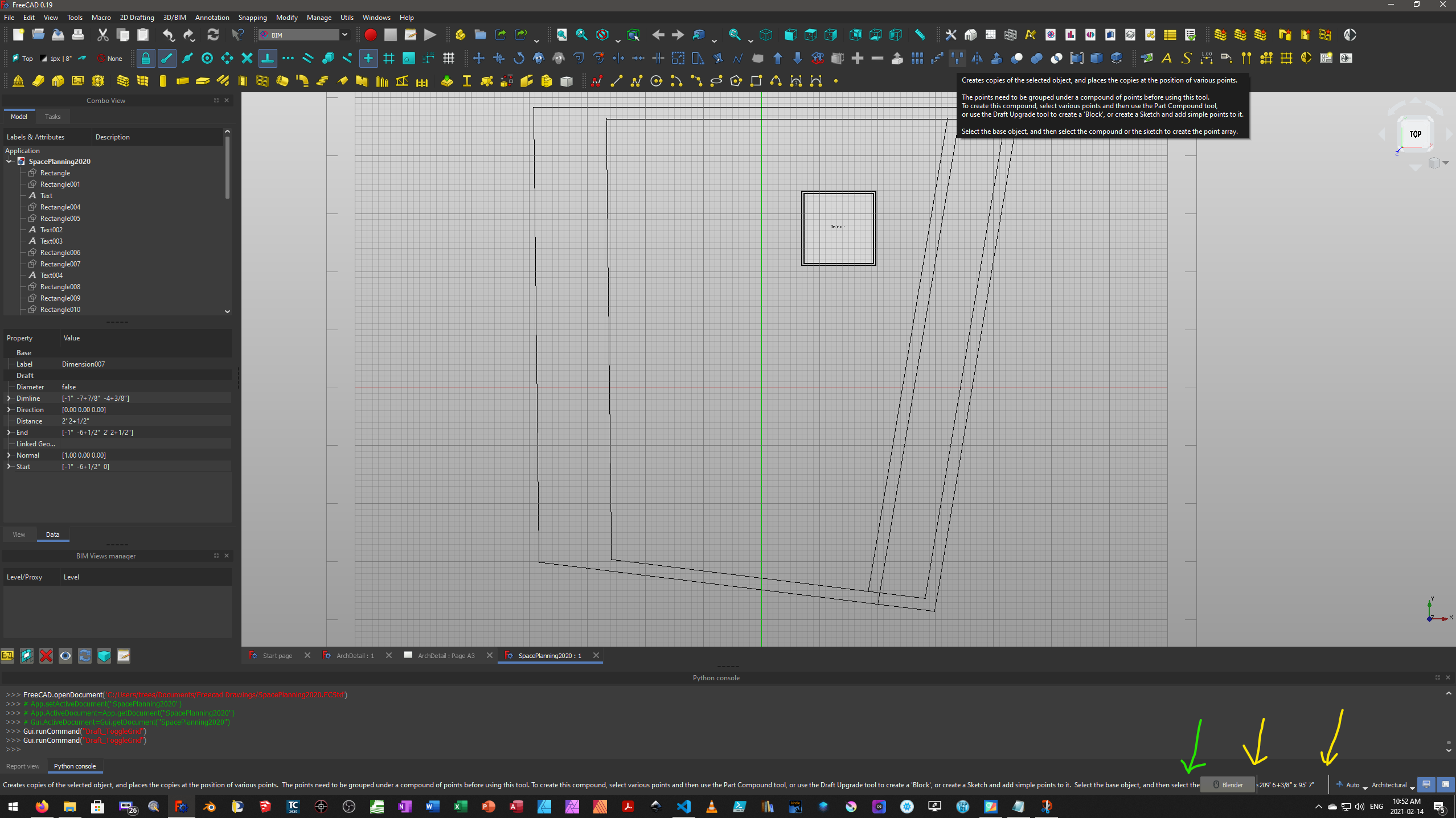

| Summary | 0004566: Status Bar Verticle Spacers are not visually pleasing. Elements can not be styled with stylesheets. | ||||
| Description | Status Bar Verticle Spacers are not visually pleasing. Elements can not be styled with stylesheets. Can we hide or make QspacerItems themeable. | ||||
| Steps To Reproduce | Using any stylesheet verticle bars look awkward. | ||||
| Tags | stylesheet | ||||

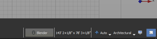

|  | We can now use Inspect Widget addon :) https://github.com/hyarion/FreeCAD_InspectWidgets/issues/1 |

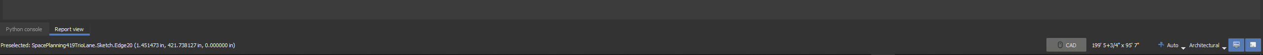

|  | Using Inspect Widget add-on was able to pinpoint sub element as QStatusBar::item QStatusBar::item { border: 1px solid #333333; border-radius: 0px; Using a border of same color renders white verticle bars invisable....and stylish. I would say we could close this ticket but not https://tracker.freecadweb.org/view.php?id=4565 as text still runs under under navigation button hovering over point array. |
