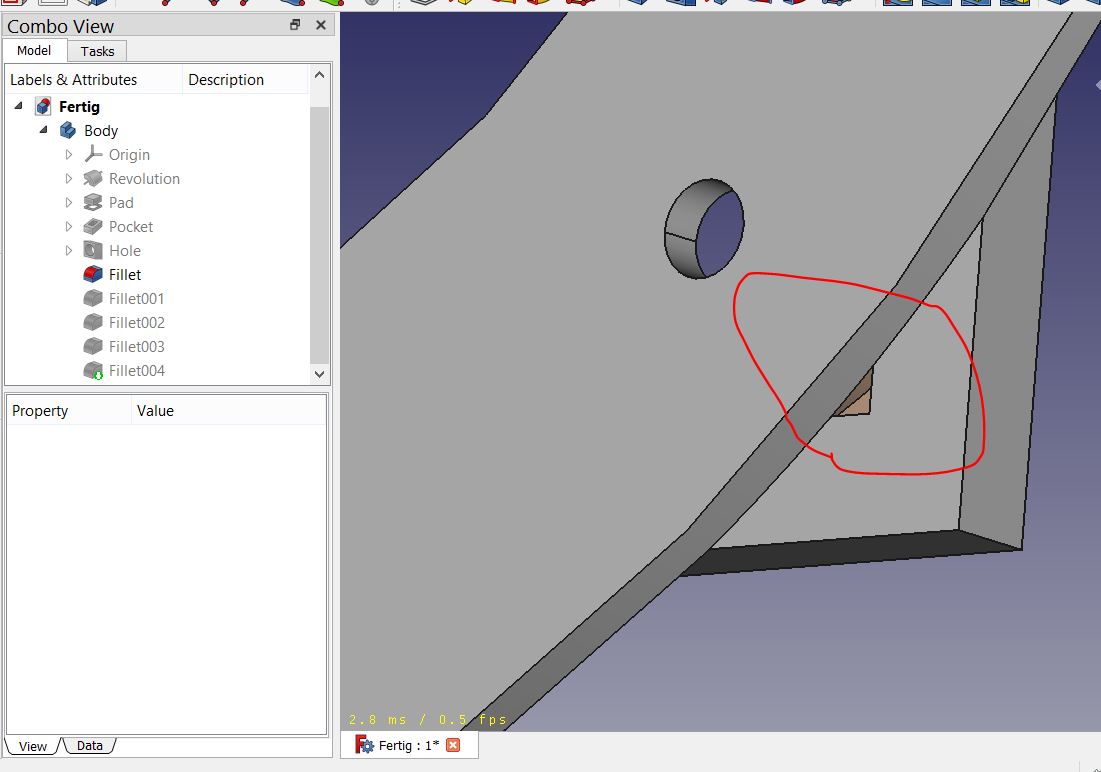

Actually that body is broken at first fillet - there is a hole at the underside. So we should not expect proper results later. This still should not crash FreeCAD. Why does crashing OCCT still crash FreeCAD? Shouldn't it just show an error?

In my testing, this is resolved by the fix discussed in 0004543.

@chennes has created a downstream patch that fixes the crash. It is slowly being integrated in to downstream packages (ATM libpack is the only one but more will follow). This issue is therefore being marked as resolved. It will be closed once all packages are patched or when (if) upstream merges.
chennes
2021-12-29 03:50
administrator   ~0016147
This patch has been merged into OpenCASCADE 7.6, and the patch for earlier OCCT versions has been incorporated into all packages of FreeCAD 0.19.3 that I am aware of.
