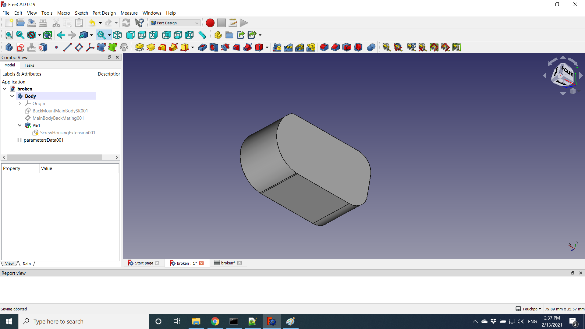

2021-02-15 01:46
reporter   ~0015344
Sorry, I forgot to attach the file in the previous comment. The screenshot shows the face that when selected crashes FreeCAD is fillet in PartDesign is clicked. Sometimes it doesn't crash the first time. However, if it is cancelled and then retried it crashes.
