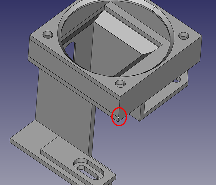

I cannot download the posted FCStd file to test, but based on the backtrace I believe this is resolved by the fix discussed in 0004543.
chennes
2021-02-07 22:48
administrator   ~0015305
OK, I was able to download the file. Edge183 is a very tiny 39.25µm (probably unintentional?) edge -- applying the patch discussed on 0004543 eliminates the segfault, but there is no chamfer setting that will result in a successful chamfer on this edge.

2021-03-14 22:18
administrator   ~0015522
I think we can close it -- that very tiny edge won't be able to be filleted, and the segfault is resolved.
