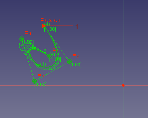

Summary0004514: Sketcher crash upon mirroring box selected bspline
DescriptionWhen box selecting a bspline such that the control points are also selected, then mirroring said selection, FreeCAD segfaults.
I would expect the mirroring code to ignore the control points when mirroring instead of failing on them.
Steps To Reproduce1. Open attached FreeCAD document
2. Box select bspline (as in attached image)
3. Select an axis or the origin to mirror about.
4. Press the mirror button in the toolbar.
5. FreeCAD segfaults

I experimented some more. Interestingly this seems to be unique to bsplines. The centre points of circles and arcs as well as the various control lines of ellipses and hyperbola do not cause crashes:
  • The control lines seem to actually act more like free-standing construction elements, and it is possible to not mirror them (very weird).
  • On the other hand, the circle/arc centre points seem to be special but ignored.

abdullah
2020-12-20 18:30
manager   ~0015163
Fix committed to master branch.
Related Changesets
FreeCAD: master 2ebed71e
2020-12-20 10:42:45
abdullah
Committer: abdullahtahiriyo Details Diff
Sketcher: fix crash on mirroring geometry defined by internal alignment geometry
Internal Alignment constraint mirroring was never implemented. With the enhancements
brought with implementation of geometry extensions in the sketcher, this lack of
implementation became a crash, as geometry was marked as being internal alignment, while
no associated internal alignment constraint was created.
Restrictions:
- Internal alignment geometry is only to be mirrored if the geometry it defines is also
being mirrored. Internal alignment geometry is otherwise skipped. This is because it
does not make sense to have a pole without a b-spline, or a major axis of a ellipse without
an ellipse.
fixes 0004514
Affected Issues
0004514
mod - src/Mod/Sketcher/App/SketchObject.cpp Diff File
